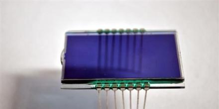

 LCD顯示屏: LCD液晶屏
LCD原理和應(yīng)用
